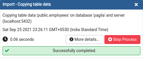

Method 3: Using pgAdmin (The GUI-Friendly Approach)
Not every CSV import needs to start in a terminal. pgAdmin gives you a visual way to import data, so you can see exactly what’s happening before anything touches your table.
pgAdmin wraps PostgreSQL’s import logic in a visual flow: you pick the table, point to the file, confirm delimiters and headers, and let it run. It’s slower than COPY and less flexible than scripted \copy, but it’s approachable, transparent, and hard to mess up.

  1. After clicking OK, a window appears indicating that the process has been completed.
Successful Import in pgAdmin

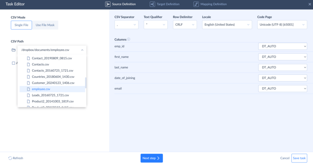

Step 1: Create an Import Integration on Skyvia
  1. Click +Create New and select Import under Integration
Skyvia Import
  1. Under Source, select CSV from storage service, and then select the source Dropbox connection
  2. Move on to Target and choose your PostgreSQL connection
Skyvia Import parameters
  1. Click Add new on the top right of the page to add an Import task.

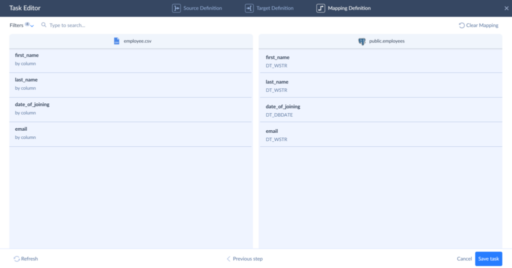

Step 2: Map the Integration
  1. In the task, you specify the file and where and how to load it.
Skyvia Task Editor
  1. Select the file to load data from and click Next
  2. Select the employees table to load data to and click Next
Skyvia Task Editor
  1. Map source and target columns to each other and click Finish
Skyvia Import Mapping

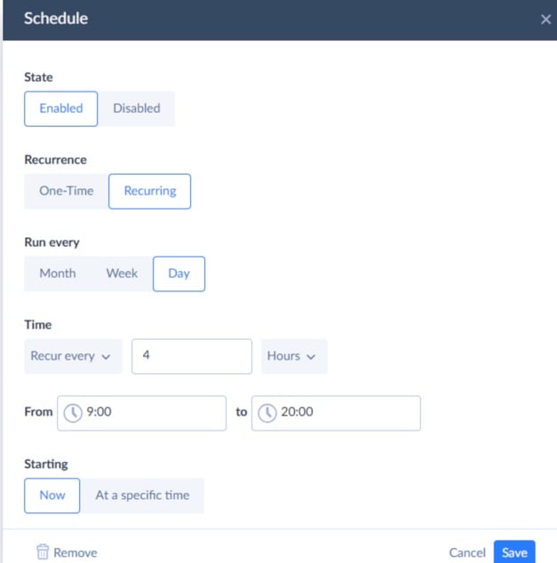

Step 3: Schedule Integration
Note: You can run the integration manually or schedule it for automatic runs.
  1. On the Integration main page, click on Schedule in the upper corner.
  2. Choose how often you want it to run and click Save
Skyvia Scheduling
