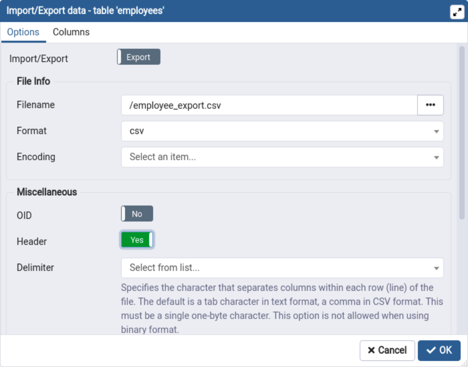

Step 2: Open the export dialog
Right-click the table and select Import/Export Data…
A modal window opens with two main tabs: General and Options
Step 3: Switch to Export mode
In the General tab:
  • Set Export/Import to Export
  • Choose a Filename on your local machine, for example:
    • Windows: C:\exports\employees.csv.
    • macOS/Linux: /Users/you/exports/employees.csv.
pgAdmin Export in PostgreSQL
  • Set Format to CSV.
  • Set Encoding to UTF8.
That tells pgAdmin exactly what to generate and where to put it.
Step 4: Set CSV options deliberately
Switch to the Options tab and confirm:
  • Header: enabled (recommended, unless you explicitly want raw data).
  • Delimiter,.
  • Quote".
  • Escape".
These defaults match what most tools expect and play nicely with Excel, Google Sheets, and other databases.
Step 5: Export specific columns (optional)
If you don’t want the entire table:
  • Open the Columns tab.
  • Select only the columns you want in the CSV.
That is useful when exporting subsets without creating custom views or queries.
Step 6: Run the export
  • Click OK
  • pgAdmin shows progress in the Process Watcher. When it says completed successfully, the file is already written.

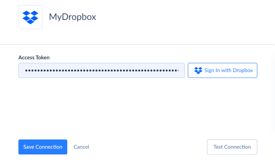

  1. Then, in the list of connectors, select the data source you want to connect to and configure the required parameters.
  2. For Dropbox, just sign in and allow Skyvia to access your data.
Skyvia MyDropbox Connection

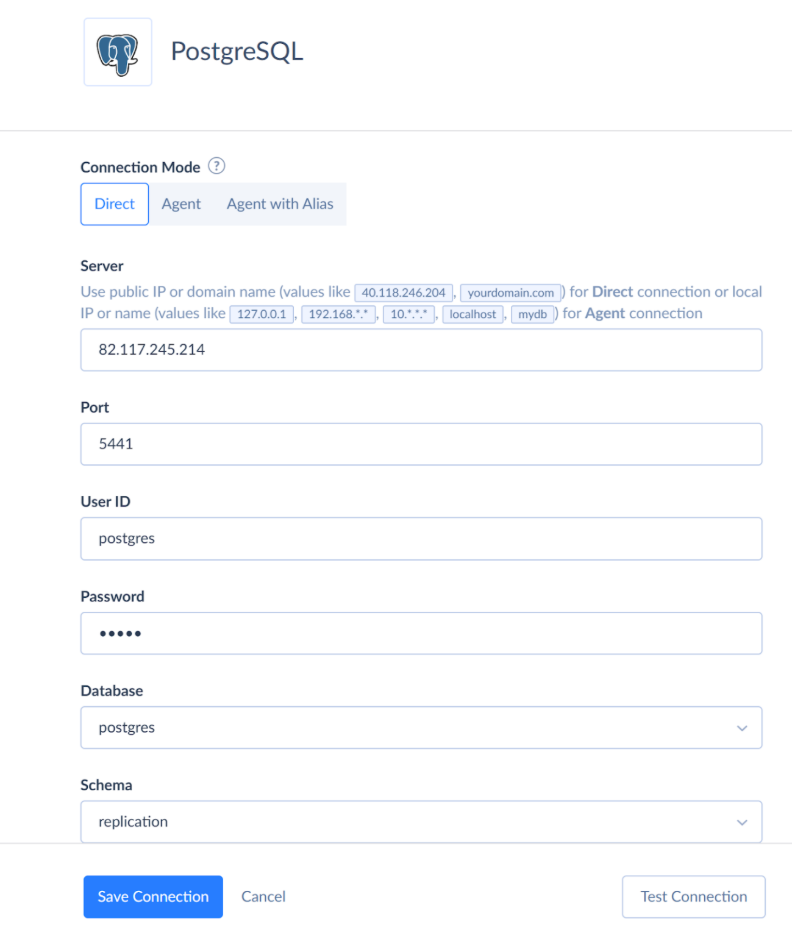

  1. For a PostgreSQL connection, enter the basics: server address, port, database, user, password, and schema. SSL/encryption is optional but recommended.
You’ve got two ways to connect:
  • Direct connection. Skyvia connects to your Postgres instance over the internet. Use this when your DB is publicly reachable (with proper firewall rules and allow-listing Skyvia IPs). It’s simple, but you need to expose the DB safely.
  • Agent connection. For databases behind a firewall or on a local network. You install the lightweight Skyvia Agent on a machine that can see your DB; it opens a secure outbound tunnel to Skyvia, so you don’t punch holes in your network. Great for on-prem or locked-down environments.
Skyvia PostgreSQL Connection

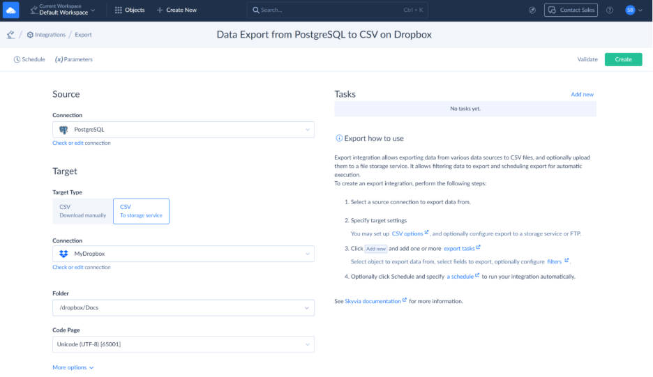

Step 2: Creating Integration for Data Export from PostgreSQL
  1. Click + Create New, then select Export under Integration, as you would when creating an import integration.
  2. Under Source, select the PostgreSQL connection.
  3. Move on to Target and select CSV to storage service. Then select the Dropbox connection you created, and choose the folder where you want to place the exported file.
Data Export from PostgreSQL to CSV on MyDropbox in Skyvia

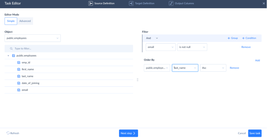

  1. Click Add new on the top right of the page to add an Import task. In the task, you specify a table to export.
  2. In the Object list, select the table to export. Here, you can also configure filters to export only some of the records, you can clear checkboxes for some of the fields in order not to export them, specify the file name and compression, etc.
Defining a Source for Data Export from PostgreSQL to CSV on MyDropbox in Skyvia
